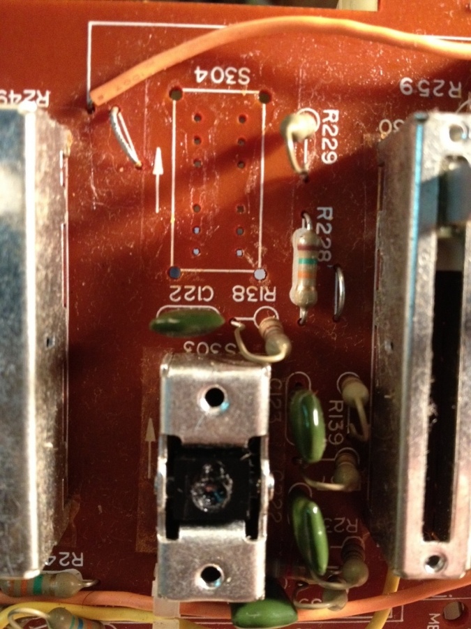

I desoldered the switch with a broken post.
Both broken flush like this one, other removed.
I had to drill out the plastic base, insert piece of nylon for a post and cross drill through bottom of post for pivot pin
Nylon post in place
Correct lever permanently fitted to post
