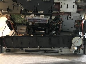

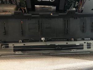

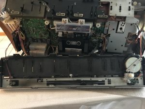

Norm, I opened the box just for taking pictures for you.
It is removable, but we have to re cord it. Looks less complicated to re cord it.
A steel plate with 4 screws are securing the dial and glass to the front and keeping it in the slot. I pushed the dial glass from the front gently and could see it going inwards. So, it will all come out when you remove those 4 screws on the metal plate.
~ Royce
