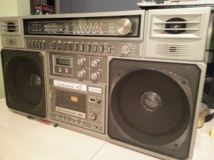

Hello All,
Thought I'd introduce myself and my (small) vintage boombox collection here. :cool:
I've uploaded pictures of my nice huge Clairtone 7979, looks pretty good considering it's a dumpster find.... :w00t:
Another find is a nice mint Realistic 14-771, rebadging of a Sony CF-515S, see the pics of that too. Makes a lot of noise for it's size, used it down at the lake all summer last year while I was repairing my dock.

Obviously my pride and joy is the Clairtone - boy does it sound good! Pretty good cosmetic shape, not perfect but not too shabby either, have all the buttons except one, amplifier works perfect. I'm going to print myself a cardboard copy of the applique around the cassette door, then it'll look a whole lot better - you can see a rough draft in the 2nd pic, still working on it.
>>UPDATE: Since starting this thread I've managed to repair the tape deck 100%, works great! Also printed myself a cardboard copy of the aplique around the tape door, looks so much better. See below for pics of both. :-D <<
Tuner is a bit intermittent, going to look for a bad solder joint - AM and SW work fine, but the FM keeps cutting in and out if I push or pull on the selector knob, tuning keeps drifting all over the place, and the microphones keep cutting in and out of the signal - weird. Also going to debug the tape circuit today, motor ran perfect at first then stopped. I've got it down to a couple parts on the PCB, wrote myself a mini-schematic of the motor power circuit, proud I was able to figure it out for myself. Bought a few components on eBay, I'll keep you updated here how the repairs go.
I really like the full complement of controls inputs outputs etc, and he digital clock with alarm is a nice touch. The touch-sensitive tuner knob is a very novel feature, took me a little while to figure it out, and the power plug polarity affecting it too. I was amazed to find it's actually worth several hundred dollars, hard to believe!

Here's a quick update. I've managed to repair the tape motor circuit, the tape player works great now! Boy does it run smooth, program search and cue / review, rock steady speed! :-D Now just the auto-stop system and the tuner board intermittent to worry about, not bad.
Here's a few pics of my repair station, tape player running (notice the blurred LED run meter), and the new parts and 'shrapnel' I had to replace off the tape player circuit board :lol:

Quick update, using a schematic I managed to debug and repair my Autostop circuit!
Found a bad SCR controlling the solenoid, ordered a new part on eBay should arrive any day now.
See the pic of the circuit board and all the parts I've replaced to fix the motor and auto-stop circuits. I made two simple scheamtics for the motor and auto-stop circuits, if anyone needs them let me know.

Anyways, latest update on my Clairtone 7979 repair work: I received a new replacement SCR for the Autostop system a while back, installed it and that's fixed, so now the tape deck is 100% operational, works great! See the pics of the new SCR in a bag and installed, beside my homemade heatsink for the motor Transistor I replaced. I've played over a dozen tapes in it, autostop works everytime.
I've also got the missing aplique panel around the cassette door done, pretty good job if I say so myself! Started with a photo of Hemiguy's front panel (thanks Hemiguy!), cleaned it up, tweaked it, printed it out a couple times (see 1st attempt, close), added a few personal touches - color logo, black Auto Search text, and printed this final copy, all sized perfect. See what you think, can hardly tell the difference, even the color is close, my Dad's color laser does a nice job, and the ink won't run if it gets wet..... :-D
I've included the jpeg image of all my hard work inside a ZIP file for anyone who wants it - I'm probably the only one missing this aplique lol (see smaller preview image). Be sure to print it out with EXACTLY the settings shown below, so it prints at the right size (see last picture). I'm afraid Windows Paint won't do, use Photoshop, or Faststone Image Viewer, great freeware program (http://www.faststone.org)! Might have to trim the bottom and right sides very slightly, all the holes are spot on, enjoy!
