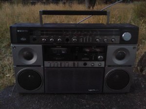

hey. so i found this at a second hand shop, very cheap, i think
few problems, missing balance knob, broken eject tab, tape deck dosent work, volume control problems, missing an aerial, other than that pretty good condition.
can anyone help me with parts/fixing options. cheers!

I also have one. But mine is completely dead. It powers on but nothing else. I was told that this radio has problems with the cassette mechanism that in part powers on the radio. If the cassette does work neither will radio. It's like one brain for two things.
The major issue with deck is there's a spring attached to drive tire that breaks over the years. Parts for these are hard to come by...
