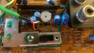

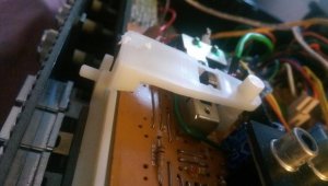

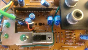

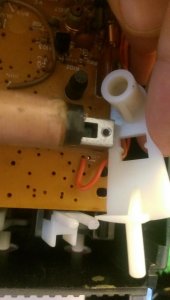

The next challenge is more difficult. The function selector knob uses a long plastic relay to operate a switch further away on the main pcb. There's a plastic lever here that appears to be broken, and looks like it was supposed to pivot at the location where it was attached to the pcb. However, the way it is mounted onto the pcb makes it appear as if it couldn't rotate at all at this point. Which is weird, considering how it seems to me it should be working. See attached pictures.
There's another pivoting selector for the radio frequency bands, and that one is mounted quite differently. You slide the lever over a fixed axis, and it can freely rotate here as one would expect. That one is in the second to last picture.
I'm at a loss how I would restore the function selector lever. If I superglue both of the plastic bits together, it won't be able to pivot and it will snap off. How did this thing ever work!? Any tips on how to fix this would be greatly appreciated.
