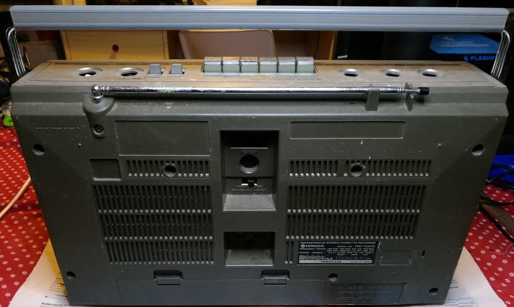

When I got the Hitachi, it was in a pretty sad state. It was very dirty and the cassette player did not work. The paint was quite worn, but not too bad. The radio worked fine and all pieces were intact. There was also a lot of crackling when operating the controls. The backpiece, speaker grills and the cassette player buttons showed some yellowing.

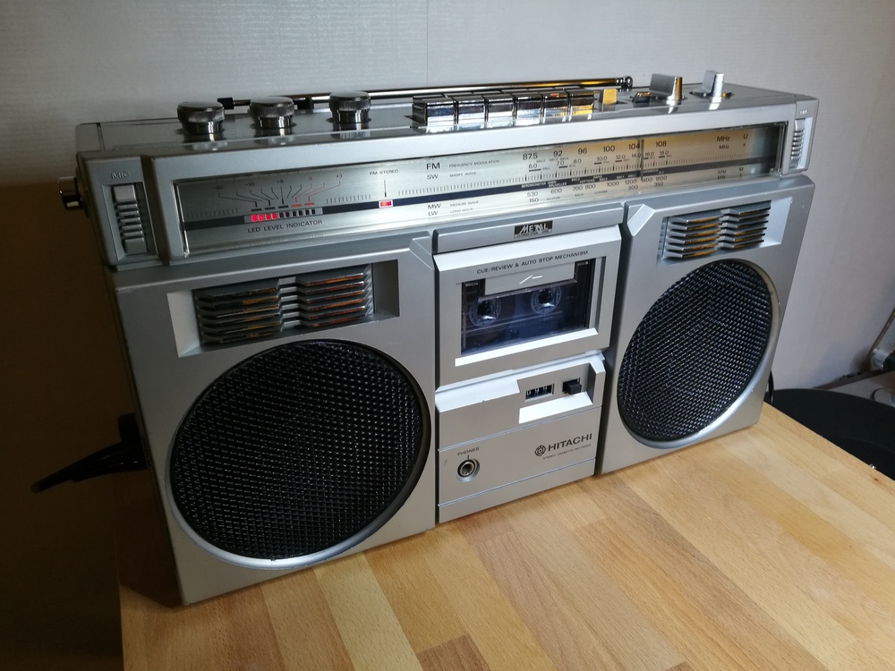

After fixing the cassette player, spraying the potentiometers with contact cleaner, cleaning the housing, polishing the tuner glass and all controls, cleaning and demagnetizing the tape head everything was put together. The result is shown below. I feel very pleased with the result! Everything is working fine including the cassette player. There is still some minor crackling in the controls and sometimes the tuner only plays in one speaker when in stereo mode, but that can be fixed by turning the tuner on and off once.
Note also the chrome that I added to the cassette controls. I think that it was a nice way of hiding the yellowing on the plastic. The painted grills are also much better. I only wish that the speakers had been more visible as they have chrome caps. The speakers sound a little weak, so if I find some suitable subsitute speakers later, I will replace them.
