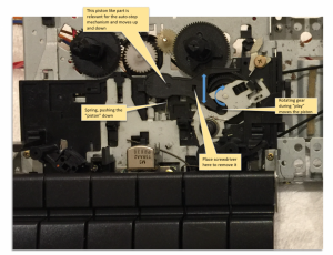

Hi Neil,
I have most of the 3Ds in my collection
The annoying clicking can be fixed within minutes an without spare parts. It is just the spring, which needs more tension to push down the moving piston. You can simulate it by gently pushing down the piston with your finger.

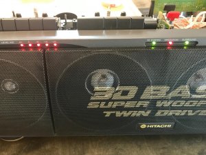

In case not all LEDs light up (I used an iPad as the Line-in Source, set to 90% volume), there is a problem. Both of my 3D88 make full use of the LEDs - no limitation as mentioned before.
