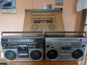

This first pic is just about all I knew before the box arrived. I failed to notice the incorrect antenna, the missing spacer in the tape control button panel or the missing 'button' on the R/H side of the cassette door cover. I did notice some grime and the speakers not looking their best:
What you can't yet see are a couple of broken internal posts, a section of broken plastic profile from beside the tape deck (inside) and the tuner window that had come adrift with a cracked corner.
