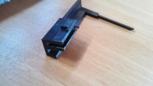

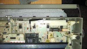

Hi,does anyone know how to reconnect the black plastic tuning arrow,back onto the string?
I've tried many ways,so I placed it back to where it was when I opened it for the photo.
Thanks

Radio-Active
The back of the part has a very small notch but nothing that grabs. There weren't any loose pieces inside.
Here's a pic of the back of the tuner indicator part.

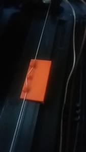

mancardo
I know it's not same box, but It looks like you're missing two other notches that should be on each side of that middle notch. I just finished re-stringing one of my boxes. see the pics.

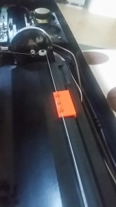

Radio-Active
Yup. Got impatient and used "liquid duct tape",straight to the string. Works well.
