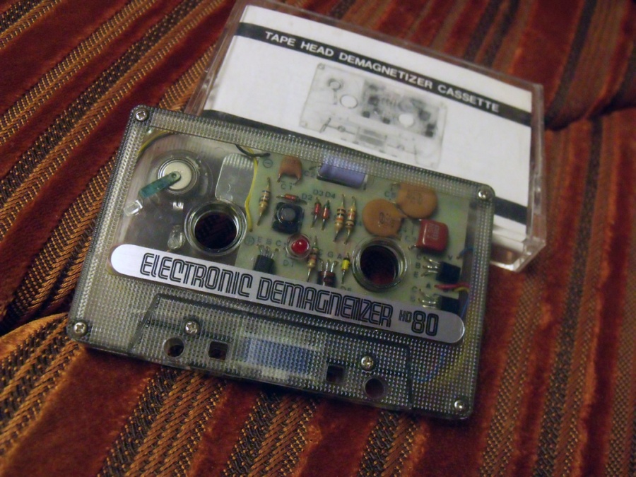

Is it true that those big handheld demagnetizers are the best? Could someone show a pic of the one they think is best?
The handheld ones can be used on heads, capstan needle, guides and almost any metal part. But it can also magnetize parts just as easily as demagnetizing them so it requires more skill to use.
The ones I recommend for the casual user looks exactly like a cassette tape but has battery operated electronic circuitry in it. Unlike the former, it can only demagnetize the heads and no other parts. But then on many machines, especially those where the cartridge goes in upside down, it's hard to even access the heads, needle, etc without disassembly. You only use it for a second or so, and it's done so pretty much idiot proof. But I recommend you put the machine in Radio or Line mode when doing it so as not to damage any tape circuitry since it emits quite a strong HF signal through the heads.
Ok thanks, I always see the handheld ones on Ebay but I don't think I've ever seen the cassette type ones. I'll have to look harder.
Here's a pic of mine, Reli.
She does the job admirably!
Thanks, Glue! Does it have an on/off switch, or do you just remove the battery after each use?

The electronic cassette demagnetizers use standard lithium watch batteries that seem to last forever. The battery in my TDK HD-30 is still kicking after three years. It operates like this:
1) Turn the volume to zero on the boombox and turn the power on if necessary
2) Insert the demagnetizing cassette
3) Press the PLAY cassette key
4) The demagnetizer will start with a high-pitched, steady tone
5) When the steady tone becomes a series of beeps, the demagnetizing is complete (usually less than a second or two)
6) Press STOP and remove the demagnetizing cassette
7) Clean the head with alcohol if you want
Having one really makes it easy to keep the play head in good condition.
As Bobby says, you need to have the volume at zero. Mine tells you it's working and done by lighting up the red LED in the middle which then pulses and then turns off when done.
