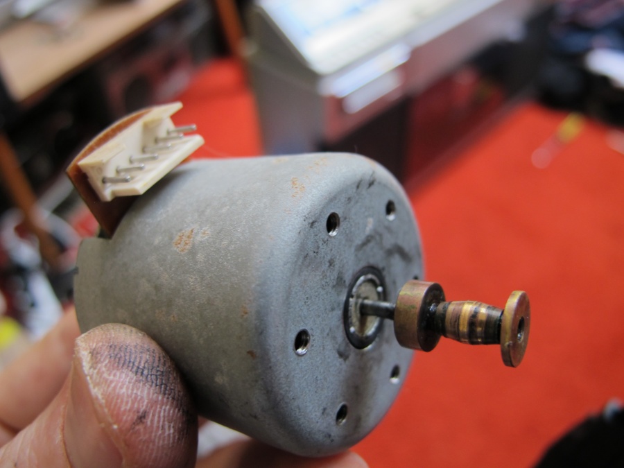

So I swapped the motor in mine with another 30 year old motor today. Tried it out with a 7" first up because it used to play ok for quite a while at 33rpm before it slowed down but on 45 it would slow pretty much straight away. It didn't slow down straight away but instead got quite erratic, sometimes slowing a bit and then speeding up even faster than it should. Now playing an LP and halfway through the B side it has started doing the same thing, slow then fast. The main turntable drive belt is new but did seem a little tight. :hmmm: These motors don't really look like they're supposed to come apart, reckon anyone can service em?

Is there such a shop? I suppose that sounds like the way to go, mine's definitely made a difference with a different motor but just not all that much better.

http://www.boomboxery.com/forum/uploads/sazeus-4215/img_1294.jpg
http://www.boomboxery.com/forum/uploads/sazeus-4215/img_1296.jpg
These do come apart but you must be careful as there's a board inside and can crack. Most Likely the issue is with the components on board. Parts may be replaceable but very difficult...the bad thing is there is probably no new replacement as this is a 6 pin motor.
If your belt Feels tight then that definitely could be an issue. Tightness causes drag and can damage parts.
