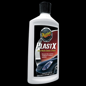

As you can see in the pics below, I painted the grills a deep blue to match the woofers & polished the tuenr & cassette windows. The radio / line-in both work perfectly & sound absolutely awesome. Take a look:

Crystal Clear Cassette Window
