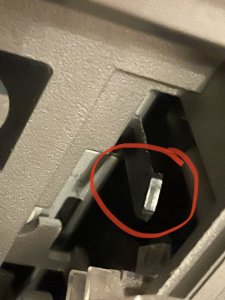

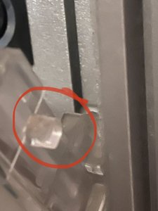

These pics show the actual ejection mechanism first and the tab the mechanism uses to lock the deck door. If tab is broken on deck door than that is why it’s not locking
