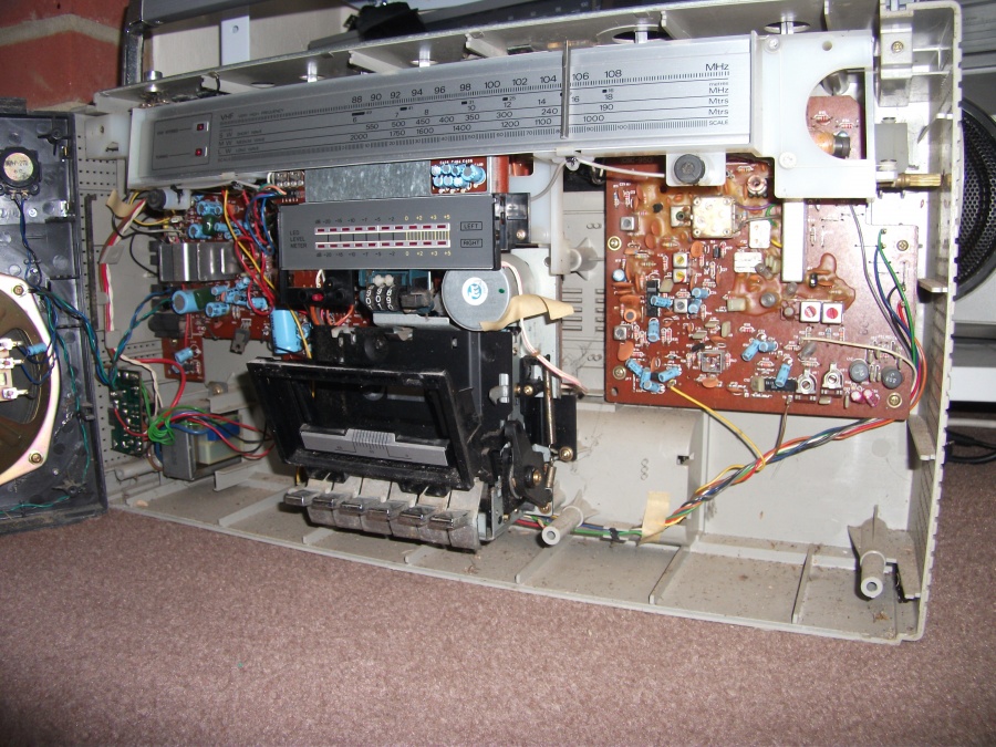

I wanted to start stripping down my 950 today for a bit of a clean up and refurb but stumbled at the first hurdle. Ive got 6 case screws + 2 more in the battery compartment out but cant get the unit apart, seems it could be stuck around the deck door. obviously i dont want to force anything, have i missed somthing.
Any help on this please guys.
the front case comes off so you have to open the deck door to be able to pull the front face off

That's correct! :yes: :yes: Before you loosen and remove all the screws, always leave the cassette deck door open. :yes:

Ok here i am one year on and ready to get back into my 950 project.
:-D
Ok the rear case, it looks a bit daunting. How easy is it to get all the guts out ala Just Cruisin's pic above? is it 3? screws on the deck then the screws on the pcbs then the tranny then it will all more or less just lift out? Or is there cut and rejoining of wires involved.
This box is going to get painted. Is there an option of not taking it all apart for paint?
How would i clean and paint without any liquids going inside, theres vents on both sides and the rear. Is this not really an option.
Surely all those guys back in the day didnt rip there boxes apart before spraying them?

This bad boy is now totally disassembled :thumbsup:
I've got a couple of worrys about putting it back together but cross that bridge later.
Ok, right now I need to know how to get the deck keys off, it looks like they are just covers and pull off?
Anyone know??
