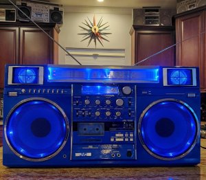

COMPLETED! Custom Blue JVC RC-M90JW!
jronyc
DONE!! Added more LED's to tweets, radio indicator and UV meters. Hardwired in a bluetooth. Replaced woofers with Advent woofers.

That is a great looking blue and the re-decal job really helps finish the resto-mod.
That just "blue" my mind! Great job! I would love to see it in person. Is the paint a metallic paint or just solid blue?
jronyc
blu-fuz…taped off the original decals. 3.5 hr.
Painted 3-4 coats Deep Blue, color sanded w/600/800 grit, pulled tape off decals. Cleared the whole thing. You have to use the whole can, only has a 48hr. pot life.... so I used the whole can. 5 coats clear last 2 laid it on think! Color sanded flat areas then buffed.
Rust-Oleum Deep Blue

90% of a good paint job is preperation. A monkey can spray a can.

Nice work! The blue adds a whole new dimension to the sanitary grey of the JVC flagship
