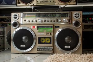

What was missing, a switch cap and the trim panel around the cassette keys?
Loooooking gooooood!
Thanks
Basically it was missing a mic cover, the tape deck keys trim and a switch cap.
The top trim was completely dented and the tuner glass was cracked badly.
Function wise nothing was working. Someone had soldered an AC cord to it, the tuner was completely dead, the tape deck had a loud humming noise and so did line in. I also believe the motor was dead or rusted...anyhow it was not spinning at a constant speed.
The back case had chips broken out of it, one antenna was missing.
Oh, and some of the tape keys were broken off.
I got some matching Toshiba cassette keys and a set of knobs from Geoff who removed them from a donor box he bought in Japan.
Thomas (CookieClassic) spent hours trying to fix the circuitry and it turned out the main board was badly cracked around the function switch and some printed resistors were probably damaged in the tuner area. We tried bridging some broken connections without any luck.
Then I got a parts box from India but it turned out to be in much worse condition than I thought so basically all those parts were unusable. Looked like it came out of a sewer.
Finally, another BB40 showed up in okay condition which could substitute almost all the missing parts and the electronics. Anyhow, I had to replace the tape head mechanism because the one that was in there had a piece of plastic broken off so the heads would not engage anymore. I personally think the BB40 deck is very poorly designed and has a lot of components that can permanently fail or fall out of place like some springs that are crucial for proper operation.
Anyhow, the curse has been broken and I still have to digest the fact that this longest restoration I have ever experienced is finally over.
