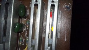

Sorry if this is a silly question, but is the red arrow in this pic where i SHOULD silicone grease, being the slide/contact, and is the yellow arrow the carbon, or is the carbon not visible in this pic? I should know this I'm sure... but I don't, and I want to be safe.
I'm almost done, got my led kit installed, but gotta get the sliders cleaned up, and put it all back together.

No. DO NOT put any grease on either of those slides. The feelers are very fragile and will "float" above the grease causing poor/no connectivity. All of the feel of the slider is the result of lube on the white nylon block (look at the knob shaft) and the side (and small top lip) of the tin housing. It's very very difficult to lube it with the sliders assembled. But if you are careful, you can use a small paint brush, or a small piece of metal bent in some fashion so you can lightly brush the interior side of the metal slider housing.
trippy1313
Okay I gotcha now, thanks again, that saves me. I see where you mean the nylon block. I'll get the hang of this boombox stuff soon enough I hope.
