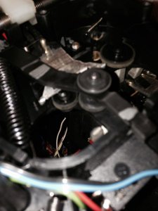

How can you tell when rubber is old and needs replacement? How can you determine the size tire(s) you need (diameter seems easy....but what about thickness of rubber)? Where can you buy these from? My telefunken studio manual is of no help. Can you see anything is wrong with the rubber tires in the attached photo. Deck plays, FF, RR very slowly.
I know this is an old post....but seeing if anyone can help.
Thanks!
