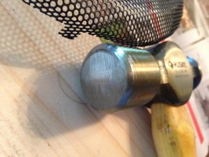

I found the best way to straighten dented boombox grills.
All you need is a new hammer and a birch wood board. If the hammer is not new, it will scratch up the grills.
As you know one cannot hit with a hammer to straighten dents because the grills will stretch and never go to the original shape.
When you use the rim of the hammer to go round at the edge rim of the grill it comes smooth and flawless.
Place the grill flat, face down on birch wood board and use the new hammer to smear and iron out the dent. It works like magic.
Why I chose Birchwood was all because the wood should be soft to gently press inward and should grab the grills too.

Good work! I've always used the wallpaper torch & freezer spray technique for removing dings from thin metals, especially aluminium and steel, which will - as you suggest - tend to stretch if they're dented. That way, the paint remains undamaged and any stretching caused by the original impact will shrink as soon as the freezer spray hits.
My shrinking hammer is fine on 22swg up to 18swg car panels but no use on mesh so I never had the cahones to give a flat hammer a shot at the job either.
if the grills have already stretched bc of a very deep dent --
there is a little tool called a shrinker//stretcher-
its in auto repair catalogues
Beosystem10 said:
:thumbsup:
Thanks john! :-D
In this case I was planning to paint it. :yes:
Sadly there is a down side for the thermal shock method to fix the dent. The paints on our boomers will lose adhesion in that sudden cooling method. The paint doesn't have enough flexibility to grab on to the metal. It is no problem for automotive coatings because they are designed for this sudden changes in temperature. I used to formulate coatingscar bumper TPO (thermoplastic polyolefin) primers for leading automotive paint companies. It has to pass Ford, GM, Toyota and all specs. One important test it has to pass in the Thermal Shock test where the coated plastic panel with a scribe is froze and then blasted with steam and checked for adhesion using 3M 828 tape.

Good to know that Ira! I will look for that soon! I never knew something like that exists. :yes:
