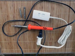

I bought one these a couple of years ago. It has proven to be reliable. Has a tip temp sensor - the ceramic heating element gets up to temperature (lead solder) in around 15 seconds! It can also go hot enough for lead free solder. I think I paid around $80 AUD with 5 tips.View attachment 26215
jimmyjimmy19702010 said:
I bought one these a couple of years ago. It has proven to be reliable. Has a tip temp sensor - the ceramic heating element gets up to 280 degrees Celsius in around 15 seconds! It can also go hot enough for all solder types. I think I paid around $80 AUD with 5 tips.
I like that unit! :yes:
