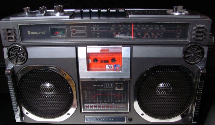

I found recently a Sound 4008 on a fleamarket.
Everything working OK but just one thing I can't figure out.
I noticed the AUX inputs on the side, but there´s no AUX position to be found on the controls.
Is it any way to connect a Mp3, laptop, turntable, ...?
any ideas?
Thank you in advance!

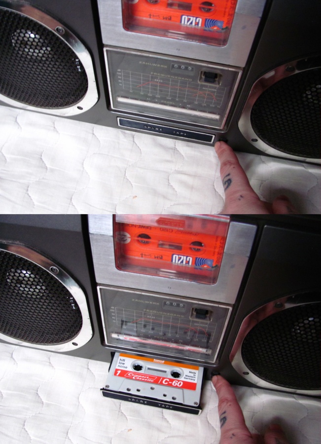

With no cassette in the player, activate the sensors that read the tape, and hit play and record while using the AUX in :yes:
On some boxes, you only need to press Record, not Record + Play :yes:
Phat looking box, by the way. I like the chome details on it. Does it sound good, or is it kind of cheaply built?
jaetee
Same as Sanyo M9990... You should also be able to put in a tape and hit rec/play and pause... but be careful not to burn out your motor that way. :-/
