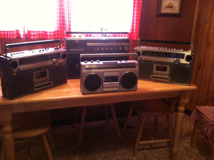

Waiting on another JVC RC-828, Panasonic RX-4940 and a Magnavox D8443 to arrive. Getting into the box collecting, starting with those I've had in the past. :thumbsup:

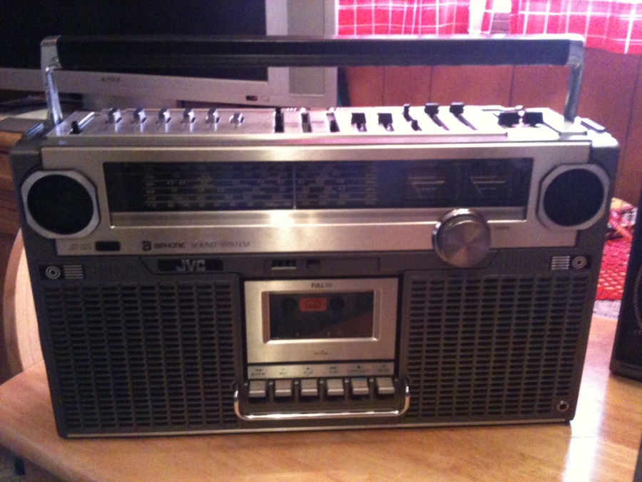

Got the RC-828 today! Good condition, sounds good but needs belts and a volume slide switch. Panasonic is supposed to be on the way but tracking says delivered to AZ! Waiting, waiting.

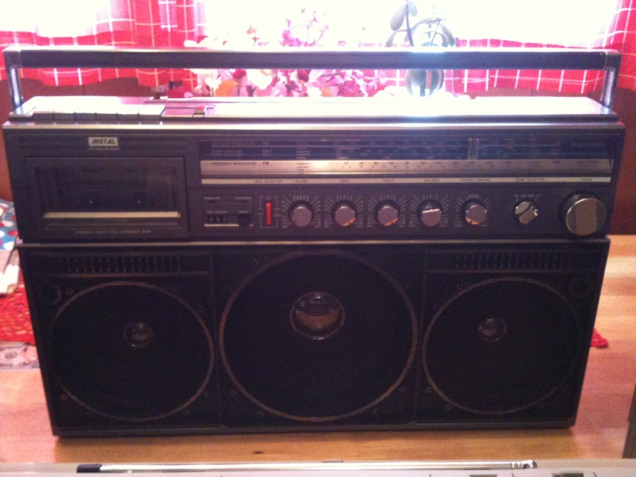

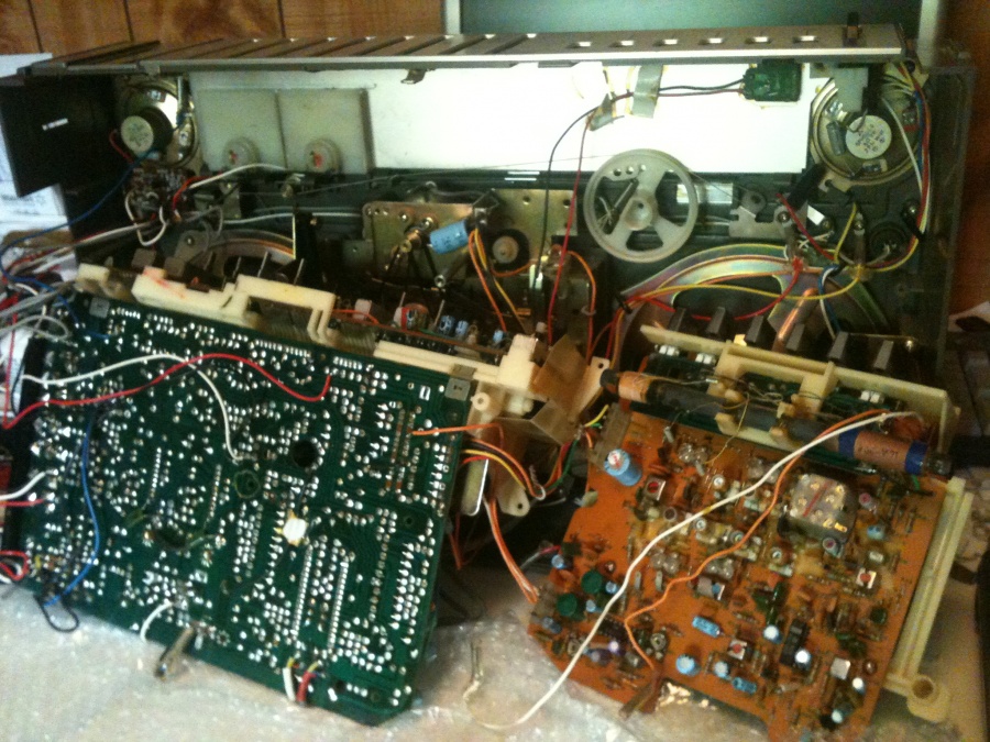

The D8443 before cleaning, belt replacements and repair of the damaged tape drive gear.

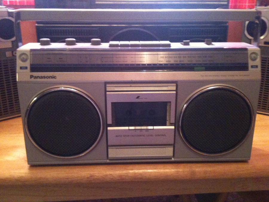

The Panasonic showed up in the mail yesterday. No sign of a stop off in AZ, as the tracking stated. Tracking numbers match but USPS shows it was delivered in AZ. The postal guy said they must've made a duplicate tracking number? Uh, how is that possible? He acted like it happens all the time? Anyway, it showed up in good condition and I'm much happier about it now! Will pic tomorrow.

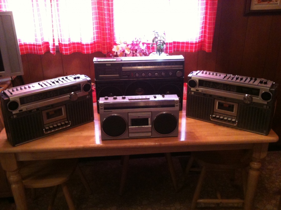

I've done minor cleaning and belt changes to both RC-828s and the Panasonic. The D8443 needs the belts changed and the typical tape drive gear, workin on a solution. RC-828 #2 needs a volume slide pot, workin on a replacement or repair solution. All in all, these do work well, other than the listed problems and I happy about that.

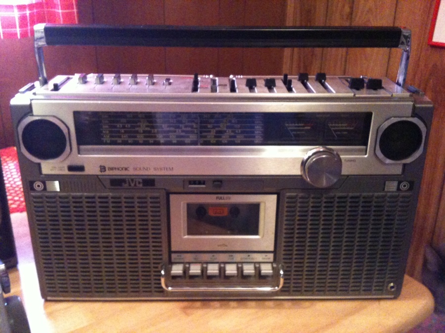

Cleaning and repair of RC-828 #2. Needed belt change, tape door shock cleaning, dial leanse cleaning and top pcb cleaning due to someones excessive contact spray.

Racked my brain for a way to repair the wiper track on the slide volume pot. Tried some unsuccessful attempts, then it dawns on me, use a pencil! Had a handy wood marking pencil that I rubbed on the track that had a wear spot and a break. Vwalla, the volume control works now! I expect only temporary, but I'll take it until I find a usuable slide pot! :thumbsup:

D8443 has decent mid/low bass, a little muddy. I added some filter caps to both mids and that helped to remove the lower bass from the mids and cleaned up the sound at higher volumes. Turning the Bass control knob fully at lower volume is ok but at mid to higher volume the loss of highs is too great. Volume knob goes to 20. Treble and Bass control knobs go -10 to +10. At +3 on Bass and +10 on Treble I can turn volume up to 14 and its pretty loud with decent bass, no real floor shaker, like it looks with the center woofer, but decent bass. This unit is only rated at 2W per channel and 3.2W for center woofer, per Service Manual, so the bass is limited by the amp and the conservative center woofer. I like the looks and it is not that bad sounding, either.
