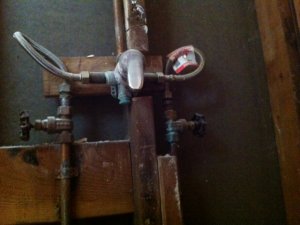

I decided to remodel the bathroom in the rental I purchased last year. It was nasty and leaky so everything was gonna get ripped out and redone.

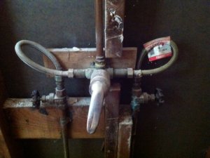

After removing the shower walls, here's what I saw. What's wrong with this picture? You construction guys will know.
Shut off valves are burried in the wall AND he used toilet water supply flexible twist on hoses! Lololol.
Both impermissible by code since they do leak and it's not possible to access them after covering the walls. The puzzling thing is that the shower head supply riser appears sweated in. Surely it costed a ton more money to rig up all that setup as opposed to a few sweat fittings? The things people do to avoid learning how to solder, haha. Another case if knowing just enough to get into trouble.
there should have been an access panel behind the diverter valve usually they are in a bedroom or hallway. so you can work on it if you ever had too. you basically had to demo the wall in an emergency if it ever leaked, or shut off the house main supply valve. also the hot water supply valve should have a red knob to indicate that it supplies hot water. needless to say the braided hoses are useless .
Behind that wall is a second bathroom, therefore, no access panel or it would be ugly as heck. And demoing a BR or hallway wall is one thing, demo'ing a finished bathroom wall is another. Needless to say, all that will need to be replaced. BTW, that isn't a diverter valve. It's the actual shower valve.

I was thinking the exact same thing Chris. It wasn't easy piecing together all those pricey brass adapters to get this to work since those flexible hoses don't usually connect to pipe thread. Ignorance is sooo bliss.
its called a shower diverter assembly, it consist of the manifold which is the brass housing inside the wall that the diverter valve bolts too, usually its 3 shafts and a spigot , but you have one that has a single handle to mix the hot cold ratio as opposed to two knobs, and once the plungers and the o-rings go out its almost impossible to not drip.
Never heard that valve expressed that way before. I do have several diverter valves in my homes over the years and they function simply to divert water from one route to another (such as from overhead shower head to a handheld shower) or from faucet spout to shower head; these diverters look like regular faucets but do not meter the water. When I plumbed my "higher" end shower 10 years ago, I used a Kohler 3-way diverter valve after the shower valve. It allowed me to select from fixed overhead shower head, handheld shower head, or body spray (horizontal spray heads). The valve that turns the water on/off or meters it has always been known to me as a bath faucet when the port at the bottom of the manifold is unplugged and connected to a spout, or a shower valve when that port is plugged. Maybe it's technically known as a diverter? Learn something new every day I guess. Kohler themselves call that valve a shower valve on their website. The diverter that I know of is called a diverter or transfer valve. Anyhow, doesn't matter I guess. I know what to buy when I go to home depot regardless of what it's called, lol.
Well, that wall is rotted out and the entire wall including studs are coming out because the bottom plate as well as subfloor needs replacing. So all are going to be replaced.
