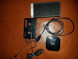

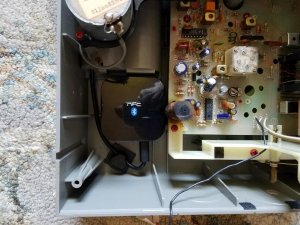

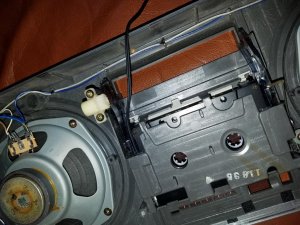

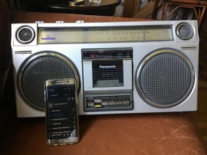

I just received a Panasonic RX-5025 in the mail pretty cheap. I had an idea to add Bluetooth but lack the soldering skills and more.

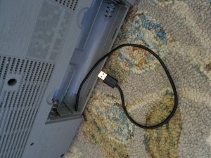

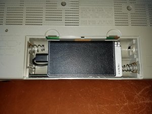

I figured this might help those like myself who lack the skills the pros have around here. Only thing I had to do was drill a hole in the battery compartment to fit the usb cord as the head of the cord was to large to sneak into an existing hole. It works great and although I can’t use while on batteries as the portable battery takes up the space in there, I doubt I would ever need to as I’m usually using AC power.
I already had these parts laying around not being used, so didn’t have to purchase anything.
