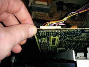

2. Before finding the handy strip down guide on here somewhere, I thought I could remove the PCB cables that connect the LP player to the PCB and in doing so pulled the solder a bit and made a small crack in the board (nothing near the circuits i don't think, just a very small one to the top corner. I have resoldered the joins on the circuit board to the PCB.
3. The LP player lit up, but only seemed to work when I pressed the reverse button. I have since tore it all down, replaced the turntable belt and pinion belt and gave it all a thorough clean, including the shell. Was very dusty and dirty throughout. Now all assembled, the LP player does not light up and there is no movement

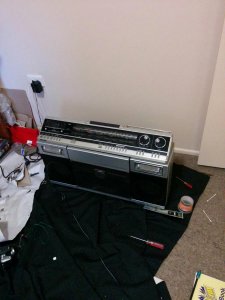

4. There are some attached photos, one of the VZ and the other of 2 Miscellaneous bits I have left over, the cog/ground looking piece was loose in the unit when I got it, the other block I think might be fore the bottom headphone/speaker board on the bottom for protection?
So the positives are - It plays radio fine, both speakers work and the rebelted cassette deck works great (at least before I broke the rod right hand side rod and lost it somehow today! GAH!).
