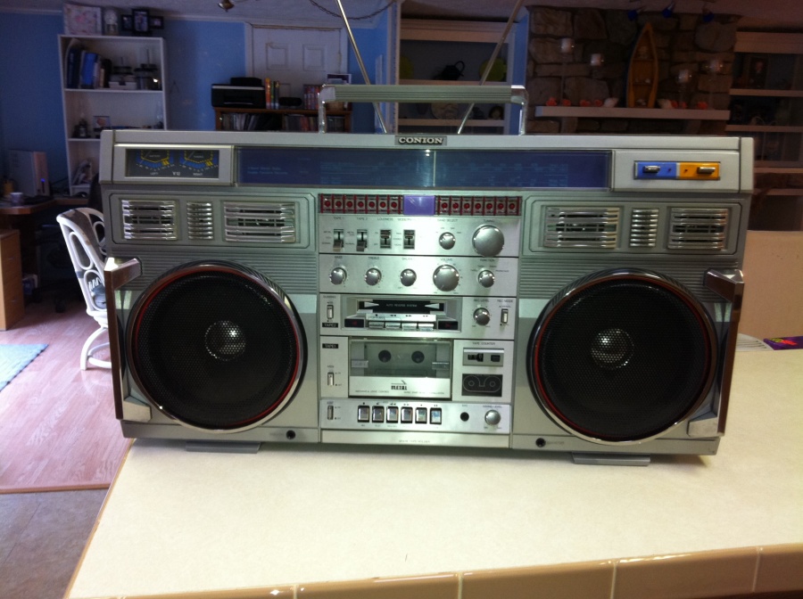

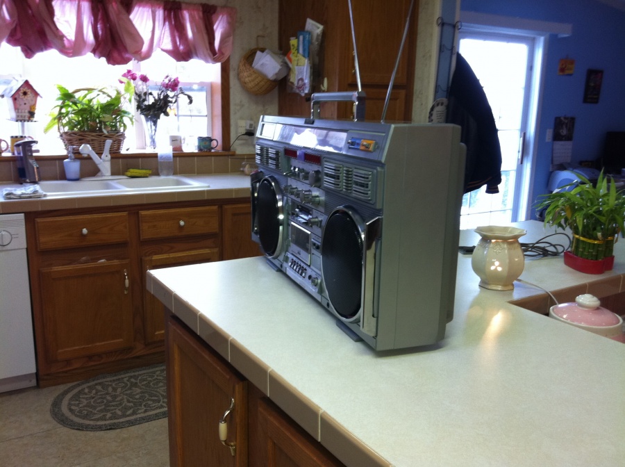

Well I finally got my 1st Grail off my shortlist...I had to drive to Minnesota to get her at 330 miles one way and 12 hours round trip with my awsome fiance, but well worth it...Shipping would have been a mere $40 and most likely this super clean box would have came broken... :thumbsup: :thumbsup: :drool: All she really needed was a great cleaning some deoxit in some controls...I will be getting 2 new antennas as both tips are broken plus new belts ;-) this baby is clean and 100% ,even working tray :-D I bought it from a guy who just got it from an older gentlemen so you know it should be nice :yes: LOOK..... http://cgi.ebay.com/ws/eBayISAPI.dll?Vi ... K:MEWAX:IT

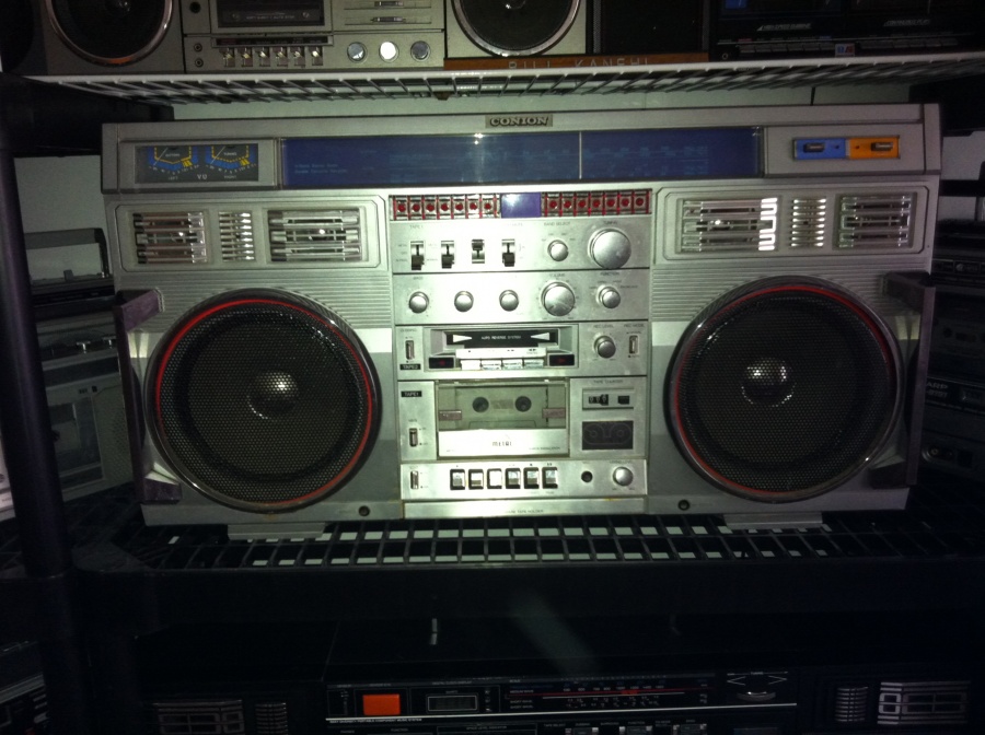

The last 3 pictures after I cleaned her up :thumbsup:

congrats man, great price, looks super clean, i remember driving to pic up my conion a mere 40 miles the excitment was unbarable, 330 mile must of been great

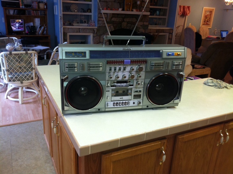

Ok so I just checked and the i931 antennas fit pretty nice as long as you for sure use washers due to the tip being a slight bit narrower. So I just ordered two for $20 shipped.... Check pics:-)

Good score Bill :thumbsup:
A nice find for a nice price
It's about time you started knocking some of those grails off your list :yes:
Thanks everyone... I will say my fiancé Jeannie has been a trooper... She allowed my dream to come true and she even came along and helped with the driving!!! Now that's Love.....She even helps with cleaning my bbx's, she is great :-)
Thanks guys, this box is awsome :thumbsup: I was a little affraid to take this one apart to clean it up and replace belts on the decks, plus the stereo was not really coming in so wanted to get that working. Well 1st I know now why everyone says its not so easy to take apart as most of the clips with wires are all same colors brown, red and orange so lots of pictures were needed...I also found out that the spring for the deck 1 was missing so I needed to make one out of and old spring I had and it works beautiful :thumbsup: I cleaned inside box and deoxited switches and some pots...I was able to clean the mono /stereo switch which now works 100%...I replaced all belts and cleaned up both decks and got together for test when :-O :-O deck 1 did not work, well I narrowed it down to a dead motor :sadno: Just by luck I have a few parts boxes and I got lucky because I had 2 - 12v 2400 ccw motors which work...So I replaced it and it works 100% :w00t: :w00t: I did notice also that someone had been in this bbx because a resistor in line with this motor had been soldered together so I will need to replace the resistor :-) Anyone with the info on which resistor this is would be a great help....So this bad boy is back together working and looking 100% even the dial lights work great ;-) Here are some pics of wiring :yes:
