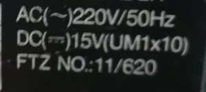

only been here a short time but thanks for any advice you can give. I’m gonna try to attach the power requirements listed on the back of that helps.

1: Some boomboxes have DC jack for second power. Usually this jack is near to AC jack.
There must be label DC 12-15 V. You can use some AC to DC adaptor with correct polarity.
2: If you don't want to open boombox and don't have DC jack, you can use it with batteries.
3: You can use some rechargeable power bank into battery compartment. You must connet to pins for + and -.

What model boombox is this?

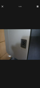

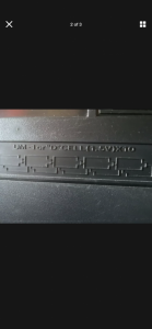

I appreciate the different ideas, seems this box only has power plug. I’ll post a picture. I really like the power bank idea and the step down/up if I need to plug it in. :thankyou:

From the photos I guess it's the following model: STR 5091
Sooner or later you will need maintenance and belt replacement.
It is best to find a radio repair service and take it there,
and they will be able to put a 110 volt transformer.
