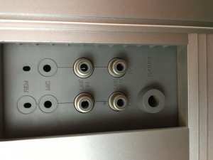

Hello guys, I have a question for you.
Can I connect the iPhone to Philips D8444 through "LINE IN" and headset exit?
I don't know if "LINE IN" is a function to listen or recorder only.
I wold like to listen the mp3 on Philips.
Thanks
