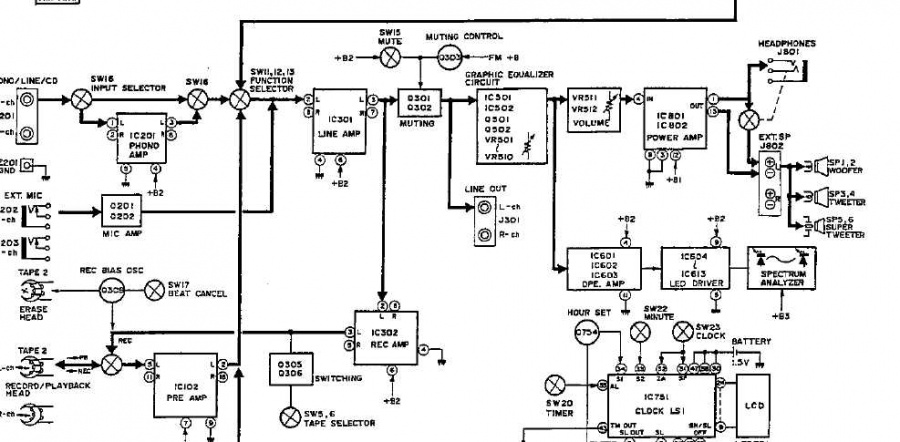

Hey Guys,
I have this beater of a Sharp WF-940 (939 with Dolby). It's a personal 'grail' of mine, so I really want to get it working, and they're selling for big $ on eBay, so can't get another cheaply.
When I got it, it had sustained water damage, had a dead channel, no FM, no tape.
Inside was dry-joint central. I've touched up a lot of solder joints and replaced suspect capacitors. FM is now working, one channel is STILL NOT WORKING!!!
So frustrated, I've tried swapping amp ICs, equaliser ICs, equaliser transistors to no avail.
Power amp is definitely working, I can hear hiss from the dud channel, and if I turn the volume up full on the dead channel, I can softly hear the bass of the music... but perhaps this is just crosstalk in the main amplifier?
Here is a block diagram...
Preamp must be working, as when I connect a device to the line-out, both channels are working. Spectrum also only shows a reading for an input from the working channel.
Apart from dry solder joints, is there anything I could've missed?

Thanks for the reply. I swapped the Amp ICs, and the same channel (left) was dead - if the ICs were at fault, the right channel would've been dead after I swapped them.
The fault is before the volume sliders, as the spectrum analyser is before the volume control in the circuit, and it shows no reading when input is played through the left channel.

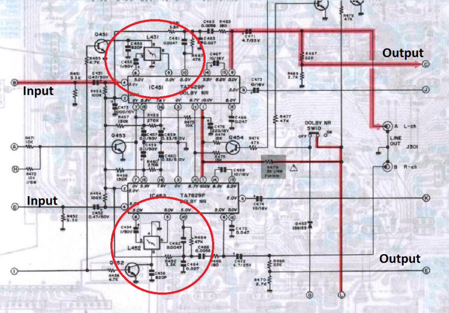

Ok guys, I found the problem by tracing the signal as decribed above...
An one of the dolby LC filters (variable inductor?) has gone open circuit. When I short it out, the channel comes back on.
Now, I have no idea how to measure the good inductor, in order to find a replacement, nor do I know how to tune it properly once I do find one.
Anyone know anything about these components? I thought of just substituting one from a junk piece of equipment, or just shorting it out and running it like that.
Markings are:
'LL00'
'84MF'
'Ja'
Any help appreciated.

Yeah, I'm not too concerned about the sound. But I've just opened up the the inductor and found the break, so I might try resoldering it first.
Not sure if it's any use. but here is the circuit...
Thanks for your help!
That is a resonant circuit, probably a filter. Certainly looks important enough since the effect is calibated for that circuit design. If possible, I would definitely recommend doing the microsurgery to restore, as much as possible, the inductor coil.
Here is some information regarding what RLC circuits can do:
A circuit containing L,C and R at a certain frequency can make L and C (or at least their electrical effects) completely disappear! The LCR circuit can appear to be just a capacitor, just an inductor, or solely a resistor! Not only that, the series LCR circuit can magnify voltage, so the voltages across individual components within the circuit, can actually be much larger than the external voltage supplying the circuit. LCR circuits can also dramatically change their impedance to offer more or less opposition to current at different frequencies. All these effects can be used separately or together to make the wide range of electronic devices that use AC.
The issue with just shorting it is that the rest of the filter components remain so the entirety of the circuit and it's design purpose has changed including the effects to the circuit.
