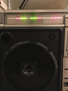

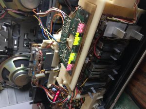

Not to hijack the thread but mine is fully working barring one bank of the led vu (left bank) do not light up when you hit the switch and the led do not illuminate when the box is playing. I thought the board was duff so bought another one which does just the same. Any ideas?

T-STER said:
Nice job, I love my 9696, so glad you got this working.
Not a problem bro! Please feel free! We are all here to help each other!
I would give the VU meter/tune flip switch a good cleaning with deoxit and see the outcome. That is next to the power push down switch/mic fader. That switch could be the culprit. In the worst case there is a VU meter LED on ebay for sale. Those switches can cause issues also clean the long record bar. I think that is tied up to a lot of functions.
