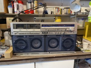

Hi all
Hoping you might be able help.

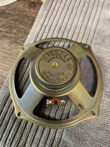

I have a Sharp Gf767 just been restoring but one of the outer midrange speakers is shot.
the original is 16PB524A these are 16cm 5W norm 10W max 4 ohm. I am looking for a replacement either the same one or a pair of similar Sharp speakers. I want to stay close to original or era as possible.

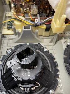

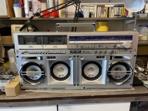

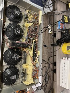

Hi all,
Thanks for all the feedback. Restoration complete. After trying some vintage Sharp speakers I went for the Alpine speaker upgrade. Found some new Alpines on EBay for a lot less than retail. Very happy with the results.

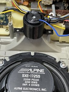

I did put some speaker damping felt in the back which sorted out vibration at high volume. also 3D printed some holders to make a good fit of the tweeters.
