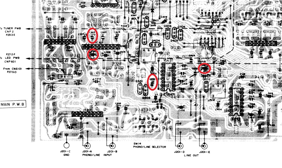

Here is another bonus from me - You don't need to check line output.
You must find and replace these caps: C303, C305, C401, C411.
Look at pic to see them locations.
You must buy capacitors with the same value from a local shop for electronic components.
If you don't have a solder gun, you must find a friend who have it.
Good luck with restoration.
