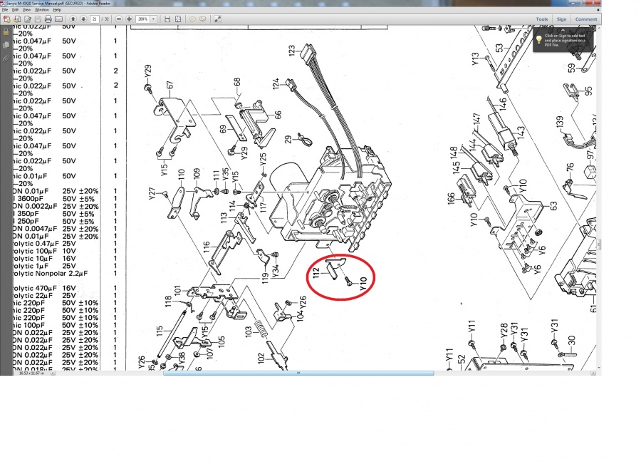

Hello everyone,
I am new to this board (and not a native speaker) and just got a Sanyo M-X 920K from a friend the other day.
Slight wear and tear and nothing missing. Line-In sounds great though the pots are crackling like hell.
Radio works as well but the program renders it useless to me. But as I expected the tape deck did nothing so I suspected the belts to be torn (in fact they just dissolved).
So, I opened it, removed the chassis, then the tape deck (Why would anyone use plug-connections all the way and then solder the motor wires to the board?) and then when I finally found a way to get to the flywheel I put in two rubber bands (please have mercy) in a way it made sense to me.
After reassembly it still didn't work although through the open backside i can see the flywheel turn for a second when i switch the whole machine off.
Then I discovered this:
I have no clue where this part fell off and how crucial it is.
I've read the board so far and know about the resistor that might have to be replaced and so on but this misterious part is the reason I registered to this board in the first place.
I fixed a busted-up Sharp GF-9090 by miracle years ago and serviced a Tascam 244 earlier this year (with service manual) so I'm not an expert in any respect.
All help greatly appreciated.
angelo litrico
May 14, 2012
4
germany
well okay, it's been progressing.
i treated the pots with "tuner 600" which is awesome, found the service manual for the m-x 920 (not k version) on this site and found out where that mysterious part belongs. and no it was not crucial apparently. i replaced the resistor near the motor wires and still the tape deck is not working. the flywheel even stopped turning like i described above after i replaced the resistor.

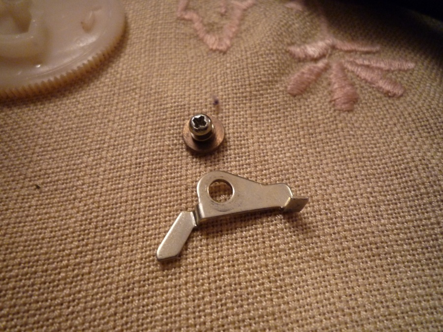

angelo, please see here the pics for the location of that piece on the deck.
Also, note the orientation of the belts. They must be right or the spindles rotate different directions to one another.

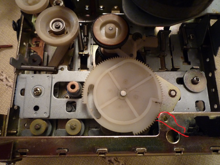

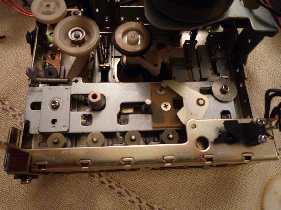

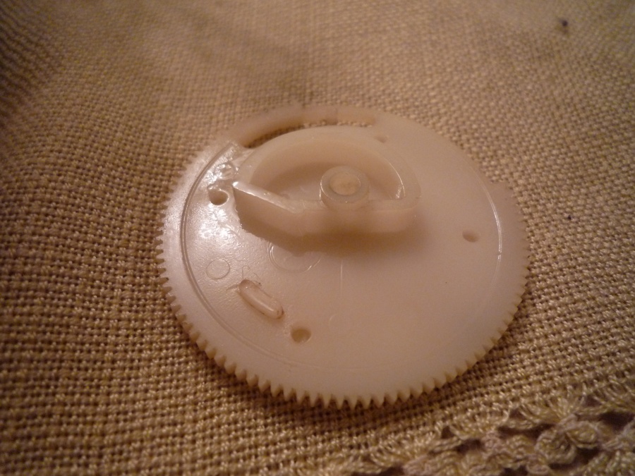

The problem with my deck was the main gear was not rotating properly, probably due to age and wear.
You can check the movement of that gear by hand and it needs to flick back to reset location which mine was not doing.
Once I removed the gear I could see why it was not flicking back to reset.
The little metal lever sits under the back of the gear/wheel and engages the microswitch to the right (see pic 2 for orientation of the lever) but was putting too much pressure on it and stopping it resetting.
So I placed a very thin washer where the lever screws in place to put a little more space between that and the rear of the gear.
Worked a treat.
Moving the gear by hand now made it reset properly without getting stuck.
When you look at the back of your deck it will make sense.
