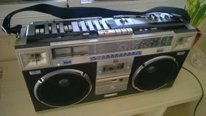

I would love to do this mod. When I got my M70, I hit that button and thought maybe it was broken since the light didn't stay on. I could understand that if you were using batteries, but when plugged in it's nice to have it stay on like old modular stereos. I really like the LED mods that make the glass glow blue too, It's much brighter than the factory lights.
sunshine_ax
Hey, I just put it together. SuperDuper is Norm (Norman) and he owns Analog Alley! Well, thanks Norm for setting me up with one of your LED Mods! I love the idea of having a bright display and it staying on when I hit the button. The instructions look amazing too. We'll see how this goes. Wish me luck :)
