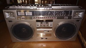

Hey all. I picked up this M71 just because I have always wanted one growing up in the 80's I have been surfing the web looking for help with a couple things wrong with the box. I didn't realize what an awesome following vintage boomboxes have and that is what has lead me here! I found this forum and have been browsing around and reading articles that pertain to me and my box.
So here are a couple questions that I hope somebody can help me with.
1. Cassette deck doesn't work. I push play/ff/rw and get nothing. When I press play after about 3 seconds I hear a click but no movement from the motors.
2. Treble slider does not have any effect on the sound. I think I read somewhere on the forum that these sliders have a history of going bad?
I have already taken it apart to do a light cleaning and inspection. I plan on deoxit in the near future. Any help would be appreciated or just lead me to post were these may have been covered already in case I overlooked them.
Over all this machine sounds amazing! It has taken me 30 years to get one and for $50 I am not disappointed!

Hi There and Welcome to the greatest boombox site on earth!!!
Congrats on the M-71, these are pretty rare compared to the uber common silver M-70 model!!!
PM Superduper About your Sliders.
At one point in time he offered a repair service on the slider board for this model. He rebuilt mine and it works
flawlessly.
So far as the deck is concerned New Belts are probably in order if they have not been replaced as of yet.
I have an M-71 and am pretty proud of it. My deck doesnt work either and I have yet to get to the bottom of it.
Plays but I cannot get the rew or ffwd buttons to depress.

Yep sounds like belts and slider repair or replacement. I had a dodgy volume slider on one of my M70's...it was repaired using conductive paint. In the end I got a replacement one as the right and left volume levels didn't quite match at the same point on the dial and it always bugged me. You could use this method on the treble more effectively maybe? Or just replace it...not too hard to do. Welcome to the forum!!! :-)
