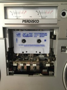

Does any one know how to take the door off the Hitachi trk 8600? Im trying to service the deck but I cant get the door off. Any help appreciated.

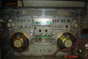

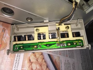

You don't need to take the door out for servicing. Leave the door open when you remove the front cover with speakers. Touch control plug will also unplug when you remove the front cover. If you grab the lower middle part of the touch control cover face upward and pull it out to the front, that section will come out so that you can unplug the short leads for the touch control buttons.
