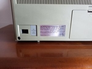

So back around 1983 or 84 my mother asked me what I wanted for Christmas and I told her a boombox.
This sucker was sitting under the tree on Christmas morning.
Of course I wanted a big, name brand box with big woofers and needle meters but with three sisters, I was lucky to get one at all.
I used the hell out of it for the next 5 or 6 years and ended up loving it especially the led meters.
When I first started working in the early 90s, I bought another box with a cd player so this was relegated to collecting dust.
At some point in the 90s I took this apart (I must've been bored one day) because the cassette player wasn't working and found a brittle and cracked drive tire.
I tried gluing it back together which didn't work since it was so hard.
Back it went under a bed (luckily I didn't toss it in the trash).
Fast forward to 2021 and with all of the knowledge I gained working on the numerous boxes I'd refurbished, I was confident I could get this working again.
I was able to find a replacement tire & wheel combo from China so I ordered 2 of them.
I thought I'd just use the tire but when the new wheel ended up fitting the shaft I decided to use it as is and although the diameter was a wee bit off, it worked perfectly.
I replaced the piezo tweeters, that probably stopped working in 1985, with 5/8" soft dome tweeters, recapped it, rebelted the player and of course deoxed everything.
The 4" woofers were still in great condition so I left them.
I'm happy to say it's fully working and with the new tweeters it actually sounds really nice.
Unfortunately, the plastic case back and handle discolored over the years but I've learned refurbing these that you have to live with things like that.
I've got it wrapped in plastic and sitting on a shelf in a closet so no more collecting dust for this one.
I'll keep it in rotation along with my other boxes.
I was bored today so decided to post this since I know you guys like seeing obscure boxes.
I'm pretty sure no one will guess what this is unless you look at the last pic (or you're one of the few that owned one).

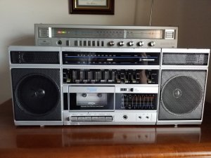

Here's a slightly clearer pic of the front (this tablet sucks taking pics).
It's about 1/2" wider and 3" shorter than the SCR-8 behind it.
The phono inputs work as aux inputs.

Ok, I see what you mean.
On every SCR-8 I've had, the gray LED surrounds have been discolored.
On those, I used very fine steel wool to return the color.
I assume the h2o2 method does relatively the same thing.
Good to know.

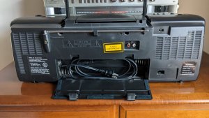

So I was a little bored and decided to piggy back on this thread with another box most of you have probably never seen.
I bought this in the summer of 1992 from Sears.
It's a little gaudy looking with the "CD" painted in gold on each speaker grille and not the greatest sounding box out there with it's 4" woofers but it did the job for the several years I used it.
I'm assuming it also has piezo tweeters but am not 100% sure.
I remember that before buying this, I had bought a GE but it skipped a few times when playing CDs so I returned it and bought this.
