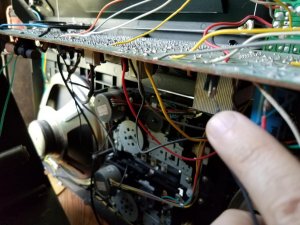

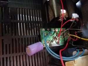

Hi guys I was wondering if you could help me. I am trying to fix my helix hx-4636 boom box. I have a black wire that came unattached and I cannot figure out where it connects to. See attached. It's long enough to connect to the small board near the power source. I've attached pics of both ends. In the first photo I am pointing to the wire I am trying to attach at the other end. Thanks.
