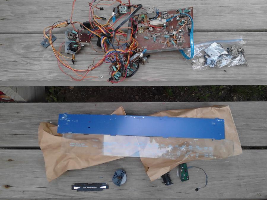

Oh I see what you mean about the posts, very strange..... Maybe it was by a heat source for a lot of its life making the plastic dry out.
This is all I have left of C100 parts:
