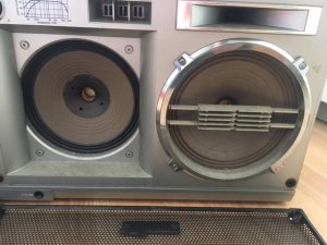

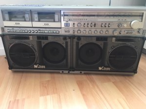

2. When I search for pictures of this Box I noticed that most of the pictures show the machine with black speakers. Mine are brown. Is this because of the age of the Box or are the speakers not original anymore? I attached 2 pictures of my box.
3. Both of my Super Woofers miss the chrome dust caps. Is there any chance to get them as a spare part so I can glue them back on? Does anybody known which dust caps I need exactly? Diameter etc..
4. The normal woofers have no dust cap at all. Is this normal?

The speakers are original, just faded. It's going to be hard if not impossible to find dust caps for those center woofers unless you just put on a different pair. These boxes get a little wobbly because they're just not all that thick - never seen one with rubber feet from the factory usually it's just plastic feet.

Yeh they look original to me, just faded as Floyd says. They all should have chrome caps. You can sometimes get them on eBay or salvage them from other speakers. The H end letter denotes the world region it was distributed in. Try a bit of isopropyl alcohol on the marker pen, just watch it doesn’t remove the paint. Try it somewhere not visible first.

Yep definitely needs the caps. I used speakers from a 9191 on my beater 777. Or it might have been an 8989? Cheaper common boxes anyway that can easily be found

yes the inside have chrome dust caps and outer have cloth smaller dust caps
they fade as you see where the dust caps were
regarding replacements should be rated at 8w
you can find dust caps on ebay but unfortunately not chromed

Hi.
You must disassemble boombox carefully.
Remove speakers, spray with black.
Check measures of caps before buy.
Maybe, they are fit for your speakers: [ebay]192144072604[/ebay]
Spray with grey or similar color and carefully glue to speakers
You can find super woofer knob here: [ebay]323230416308[/ebay]

2) Speakers are faded. There are topics here with tips on respraying speakers - use the search box to find them

4) Correct - the woofers on the edges of a GF-777 have no chrome dust caps

4) I dont know the 777 so well but the 909 has dust caps on the outside woofers

I like the look of the brown speakers (except the missing dust caps of course)
Maybe I let them as they are if there is no difference in sound quality.
OK. This cloth dust caps looks even more difficult to get. :bang:

I think the inside are 55mm outside 30mm
Not sure how they measure is it the down size of the cone or the outside of the v up
will be interesting to see if this guy has them I would be interested too
