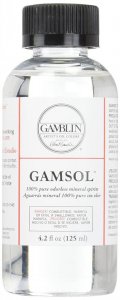

Hey Norm, I have a Sankei TCR-S90 with a silver control plate. It's not regular silver paint, but something a bit more reflective than that. It's actually a pretty good imitation of aluminum. The problem is, the seller taped the doors shut with Scotch tape, and the residue still shows. Since this type of paint is very fragile, how do you suggest removing the tape residue? Rubbing alcohol? Goo Gone?
OMS (Odorless Mineral Spirits) dissolve adhesives normally without dissolving the paint.
Adhesive remover available on local paint shops normally contain aromatic fractions that can ruin the paint in some cases.
Never use just Mineral Spirits, they contain 7% aromatic fractions like toluene, ethyl benzene and other fractions that can kill the paint.
I will try with a Q tip and work at a corner of that dried adhesive part. It is available at walmart!

Thanks! You say never use 100% mineral spirits? That Gamsol you posted says 100% spirits
Dec 3, 2010
5,759
274
Chicago, IL
It has to be 100% mineral spirits. Not the one containing 7% aromatic fraction. Gamsol is perfect for the use.
Sorry If I confused you!
