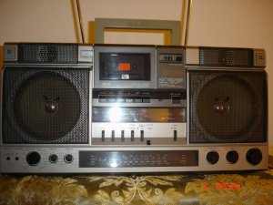

Hey there, my name is David and I'm new to this forum so please forgive me if i sound clueless. Basically what happened is, I found this pretty cool looking boombox at my grandparents place, like extremely neglected and they gave it to me saying it doesn't work.
Thing is, it kinda does work. Like the radio is okay (maybe i just don't know how to tune it properly) and I can connect my phone using aux and the sound is alright.
However there are some glaring issues. First up, the entire cassette part of this machine is busted. This is my first boombox so I got no idea about technical terms or whatever but even I can tell it's gone. The cassette door is straight up missing, the buttons don't do anything (eject button still works so that's something lol)
Also there's this display kinda thing on the side? Doesn't work either. Screen looks whited out and none of the buttons do anything.
Also, only one of the level display lights work. Actually only one of the speakers work so that's probably a more important concern haha. The right speaker works and the left speaker level indicator works. Also the clear plastic is really dirty.
So yeah that's the gist of it, basically I want to try restoring this baby to whatever level possible, but like I said, I'm new to the scene so I'm pretty clueless.
Here's what I'm hoping to achieve:
1)Find or fabricate a door for the cassette
player.
2)Fix the left speaker (hopefully the level indicator as well)
3)Fix the cassette player (i don't even know what's wrong with it)
4)Fix/replace the display thing on the side
5)Clean all the clear plastic or even better, replace with a darker plastic/fibreglass
6)Touch up the other aesthetic defects on the outside
Some additional constraints: I am a second year college student on a 2 month semester break so while time is not an issue, money is. Also I live in India so getting parts is probably going to be difficult.
I know what I'm asking for is gonna be really difficult but there isn't really any boombox culture here in India so I got nowhere else to talk about this. I'd really appreciate any suggestions, opinions, ideas, and if by some crazy coincidence someone has already gone through this, figured everything out, and is willing to help me, that would be amazing.

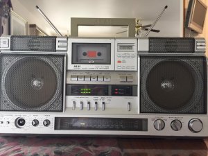

IPSS is a music search function. You can search songs based on the number selection you make (press and select a number) when you engage both play and fast forward or play and rewind.
I have the same model in very decent condition all working but missing a volume knob.
IPSS is like AMSS system (Automatic Music Select System)
The tape door is same that of AJ 505 model.
I also have that model in my collection.
Wow its really cool to see this thing in good condition, mine has a lot of scratches/dents and other cosmetic things that I dont think I can fix. Honestly I don't mind them too much, I think it adds to the vintage aesthetic. I think the only cosmetic issues that I want to fix are with the clear plastics and the cassette door. Your pics also helped me realise that my unit is missing the back cover of the cassette player as well thats supposed to hide the mechanism. I'm guessing maybe someone tried repairing this and then messed up because I dont see why else that piece would go missing as well. Also that is really interesting about the IPSS, like see I was born in 2003 so I honestly don't know much about cassettes and the associated technology. But now that I got this machine, i really want to fix it haha

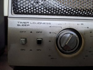

Those buttons are for Loudness (which pumps up the bass and treble for low-volume listening), and Sleep Timer (turns off the unit after a certain period of time, usually 30-60 minutes)
Okayy I didnt have the patience to test the sleep timer thing but the loudness button definitely does make a difference, even ifthe boombox is firing from only one speaker.
