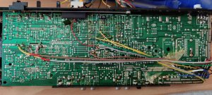

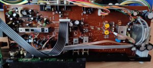

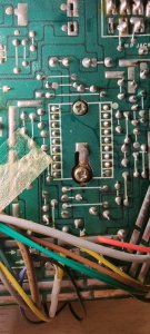

I put some pictures along of the board, if somebody would point me some advice, where to start looking the problem

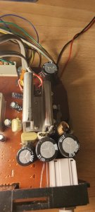

Do you mean this part ? I do lack "knowhow" how to check an amp ? But when touching the two long row of soldered points, it does affect on speakers, both right and left speaker make loud scratch sound when the screwdriver hits on to some points, but nothing more. How should i proceed ? Towards success, i hope :thumbsup:
That looks like the amplifier section the piece of aluminum sticking out of the board is the amplifier heat sink the amplifier IC chips are mounted to the heatsink and go into the circuit board. I guess the first thing you should do is check the board and the parts for any visible damage. Also don't be afraid to sniff around because sometimes you can smell what you can't see.
Reactions: skippy1969
The most likely components that will fail from stray screwdriver tip contacts are going to be semiconductors, such as transistors and diodes. IC chips are made of scores of transistors and diodes encapsulated within. When you short a transistor emitter to ground, it will blow in microseconds. That's why you never probe around in a live circuit without knowing exactly what you are doing. Even technicians that know what they are doing still occassionally damage components when the probe slips or they probed the wrong solder pad. Now whether it was an accidental contact (like your original scenario) or a purposeful deliberate contact (like what you are currently doing to the IC chips), short the wrong point AND IT WILL BLOW. If you haven't already, continued probing is a sure way to brick your circuit for good. BTW, randomly shorting amp chip pins to illicit a response is like blow torching an ant to see if it's still alive. What if there was crackling... did you just blow it in the process? Or did you just happen to short a power pin to the speaker pin therefore making an audio response?

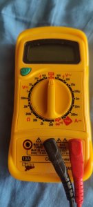

I agree, very bad idea to mess a circuit board or these soldered pads with a screwdriver :bang: but the damage has already done so...who to blame, well.. me, myself & i :sadno: I have a very simple multimeter, in what position it has to be when checking e.g. transistors or diodes and most importantly what the multimeter should tell you in numeric values ? If some of you have downloaded the CS-600 service manual as i, do u have any suggestions what part (s) should i check first ??
