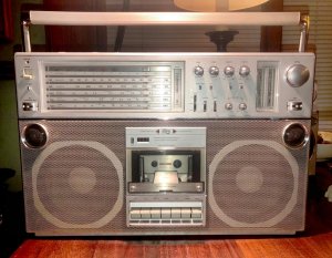

I've just gotten one of these for Father's Day. My wife is amazing! I'm looking forward to getting into this one :)
I got mine and I've been cleaning it up. I'd LOVE to do this mod. Is there a video of this? Do you still do these mods for people?

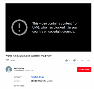

Here's what I get when I try to watch the video. I was wondering, on your mod, when you plug something into your new port does it just play on the speakers without having to switch anything? I've noticed that there isn't a switch anywhere for the aux in functions. I get it that the tape deck is required to make that work. My tape deck is just shutting off every time I push down the PLAY button. So, the record and play won't work either.
I've cleaned up the pot's so it isn't making that hideous scratchy sound anymore and the stereo is tuning in to stations beautifully now too. Very happy with the sound and MY GOD it's a beautiful box. I LOVE when they have their controls on the front.
I'm trying to be more tech savvy and understand this stuff. I've really gotten out of my comfort zone with these artifacts and have learned so much already.
Thanks in advance for any help with this.
