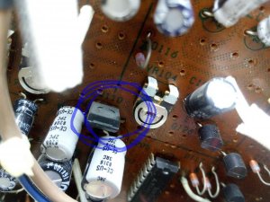

After miles and miles of loud music with my awesome gf777 yesterday a bad thing happened. After a 8 hour battery session we connected the boombox to a power generator. It worked nice for a while, until one idiot of my friends accidentally moved the power knob on the generator, leaving my boombox overloading. I runned there and disconnected immediately the box from source but it was not helpfull. I retried switching on the box:
The red power light goes on but no sound comes out. Tried from batteries and home source too but same thing, so i exclude a power supply fail. Vu meters doesn't move when radio is on, and no light comes out. If I move volume knob fast i can hear some crackling, so amp is ok too.
I opened the box and checked fuses. They were all ok. I don't have so much experience with electronic parts but i suppose it's a transistor somewhere on the upper side or something like this. My box is in trouble, help me to save it :(

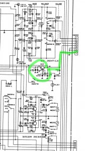

Ok, that's fine. But the problem could be so many different things, where do we start when you have the boombox and we can't look at it. For example, here are some issues with your description: #1, you said that the power indicator lights up. That's great, suggests that power supply is still ok. But the tape mechanism motor runs directly off the rails so if you have proper voltage coming out of the power switch, I'm thinking that your cassette deck motors should run, but I think you said they do not? You mentioned that tuner does not work. That's fine, but how about other modes? Line-input? We need to know. If you think that a transistor might have failed, then you can try to replace Q110. That is a regulator and it's failure could certainly account for no tuner action. However, I do not believe that regulator controls your deck motors so again, do we have multiple failures, or a single more global failure?

Normally, I would not even recommend replacing that transistor without first doing standard testing. This includes doing VR measurements and compare to the specs in the schematics. Armed with a set of VR measurements, it will go a long way towards finding the source of your problems. You apparently do have the schematic so if you want to know how to troubleshoot, then that is the way. That may seem like it would take an enormous amount of time, and it most definitely would if you don't narrow down the potential problem areas. This is where experience comes in and symptom analysis used to rule out areas that are probably good. In any event, if you want to be sure whether Q110 is good, and how you "should" be starting the diagnosis in this repair, then you would:
#1, check for proper voltage at the power switch.
#2, check for proper voltage at pin#1 of connector CNS/P 801
#3, check pin#1 of CNS/P 1 for voltage, approx 12.
#4, check live volts of B/E/C of Q110.
That's just for starters. Because each check above branches off to a different diagnostic path depending on the results of your test, it could soon get very complicated. So therefore, let's just keep it simple for now.
As to your question about the VU meter lights. You stated that your meter lights do not work. It could be as simiple as your bulb burnt out. After all, it doesn't typically light up until you press the button and when's the last time you did that? But you are correct, if your bulb is good and does not light up, it could be a whole different problem. If you want to know for sure, then just check the bulb. You can certainly do that and report back to us so we have more information and provide you a more informed recommendation. We can only go with what you provided and bulbs is not something we assume is good or bad since it is a common failure part that isn't critical to operation and therefore, most folks don't even know if their bulbs are good or not. If you can change that transistor, you certainly know how to check that bulb for continuity. BTW, that transistor is probably not critical insofar as what to put in there except that it should be rated at the same current capacity or higher than the one in there. Also, pinout assignments might differ if you use a substitute so don't presume they are the same and check datasheets of both devices before installing.
