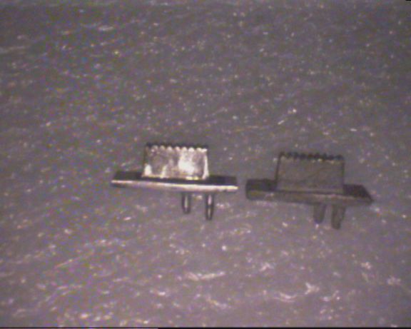

Duplicating the w800 Pause Slider:
These double cassette walkmans come with a slider for the pause function that engages the actual switch below at 90 degrees instead of head on. I think the origibnal design has a U shaped plastic loop that engages the switch. All that mine had was one leg. So I decided I'd atleast give it another leg while duplicating.
MOULD : I used a tiny inch square box to make my split mould using addition silicone. I got the main slider knob details on one half and a tiny tube like impression corresponding to 'one leg' on the other half. Just near this was a tiny 'dent' like impression corresponding to the spot where the original 2nd leg was. So I drilled a small hole in this location to approximately the same depth as the first leg using a 'tapering fissure diamond' ....that's one of the things we dentists use on your teeth folks...poor Doc P doesn't have any fancy drills ...only his dental tools :-)
All mass produced plastic components are made in molds & tapped out - so the first thing is to figure out how to align the component such that you can make a top half mould and a bottom half mould without allowing any locking up of the component due to undercuts created by improper alignment.
Sometimes there are non functional slots or grooves which can be 'blocked out' with candle wax.
In dentistry small moulds are made (to make acrylic crowns) in a small inexpensive brass conatiner called a Jacket Crown Flask. It is more like a small cylindrical box that opens halfway .slots on one half and brass extensions on the other enable precise closing of the halves.
Plaster of paris or dental stone makes an excellent one time use mould because it is accurate & rigid - but due to the rigidity it is sometimes cumbersome to pull the component out while making the mould.
An alternative is to first embed the component in wax or plasticine with the top half exposed. Mix putty silicone and press it over the component. Remove. Now inject low viscosity light bodied silicone into critical areas like the teeth and place the putty impression over the component again. Remove. You now have the upper half of the mould in Putty with important details in light body. Remove the component from the plasticine/wax & seat the top half into the mould half made. Smear alittle vaseline over the exposed areas of silicone & repeat the above procedure to make the second mould half.
The two mould halves are now used in conjunction with any chemically curing plastic to form the component
Duplication Material:
I use acrylic material available in clear/dental pink and dental yellow-white coz...that's the stuff i have The second photo shows the rough product with the excess overflow 'called flash' which is trimmed to produce what you see in photo 3.
A dental lab will convert the acrylic to metal by investing and casting...
As mentioned earlier this is both REPAIR and DUPLICATION. Notice only one leg in the original slider and notice the second leg in the duplicate made possible by drilling a hole (to form the negative impression) corresponding to the size/location of the missing leg
Adding a leg to the original slider is possible ...but a joint is always a weak spot. This way the duplicate becomes a single piece durable replica with repairs added in
In situations where you only have a picture of how your slider should look...make a prototype by grinding away/cutting away a rectangular pencil eraser to the required shape for duplication or use a combination of candle wax carved to shape with grooves and such and a strip of old CD case acrylic (for support) to make the actual sliding portion ........
