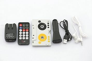

I had one of these some time back. It worked, but the problem was, every time I turned it on, it would start at the first song. So even if I had 500 songs on it, I only heard the first few. Even on random, it would only play the same first ones in the "random" order.
Interested to know if this one is better.
caution
Mar 25, 2014
2,506
341
Boomboxery
Chris, you probably have the one that's been around for a while, with a remote. If so, you can jump songs by entering a number on the keypad and hitting enter (play). So if you have 500 songs, any number between 1 and 500 will access a track. I think it sorts by date.
