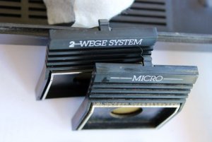

This unit was rather clean, so my soapy adventures were limited.
However, there is always some dirt/gunk under (tweeter) grills, as well as in ventilation slots. In this case, there is also missing a piece of plastic where antenna was anchored (broken screw point and some). I believe that can be taken care of, using advice from Boomboxery. :yes:
Grills are removed and disassembled with Kitchen-Dull-kinfe (c).
Of course, some cleaning is easily visible, even before "bathing".
