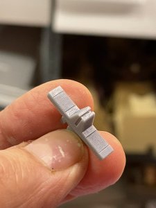

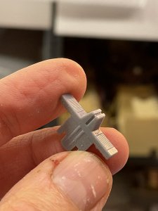

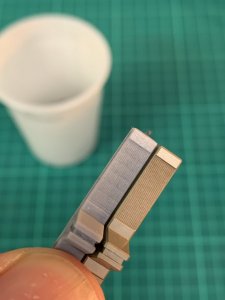

Hi all.
thought I would share these to get some feedback. I have been working to a 3D design for the VZ sliders. Being a perfectionist I have spent many hours tweaking the design and running test prints to try to get them as close as possible to the original. I even bought a new 4K resin printer as wanted to get the best detail possible. I then upgraded the said printer as wasn’t happy with the stock results. I have even purchased some airbrushes and compressor to finish them as ordinary spray paint will be too thick . By the time I finish, these will probably be the most expensive sliders ever, but must admit I am enjoying the process.
anyway I think I am getting pretty close to having a final printed version that I think is not too bad. The grooves are not quite as fine as the original, but I have played around with so many tests and this seems to be the optimal size. if I do them any finer you just don’t really see them. Anyway here is an unpainted sample along with the original. Would like to get your feedback on what you think.

Thanks Caution

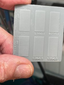

Was also really interested in your clear plastic part, was that cnc machined from a sheet?
I have a phrozen sonic mini 4K resin printer that is fantastic for the price, really makes printing your own part accessible. It can print down to 35microns in the xy axis and 10 microns in the z axis. Although it’s a budget printer, so I did some upgrades to improve build quality.
These are great machines for home projects.

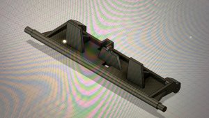

i can actually reproduce the same scale grooves as the original slider, but not convinced they will be as clear once painted. I attached some more pictures. I have also designed the door release as I have a broken one but I have not printed it yet.

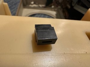

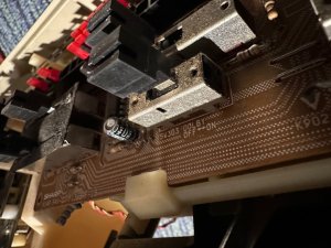

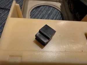

This is really interesting. I recently bought a VZ-2000 and had to open it up to put in new belts. As part of this I found that several sliders are broken, but I also have another problem. Not the sliders, but what the sliders slot into. Have you or could you 3D print some of these? I need at least 2 as previous owner superglued the broken sliders into them. I can't remove the plastic so need some new ones, as I can't plug in sliders. The slider plug itself slides onto the metal slider mechanism easily so could be replaced. Photos attached but let me know if you need any other info!

If you can't get your plastic and glue out with a grinding bit then you could always ask here or these two ebayers (1, 2) for spares. Unlike the sliders they're not impossible to find, you just need patience. Printing requires an intact sample in-hand to model properly. Unfortunately that's not you or me. Even if I did, I only post to Shapeways (I don't own a printer). I gave away a design once and they sold their own prints, profiting off of me
