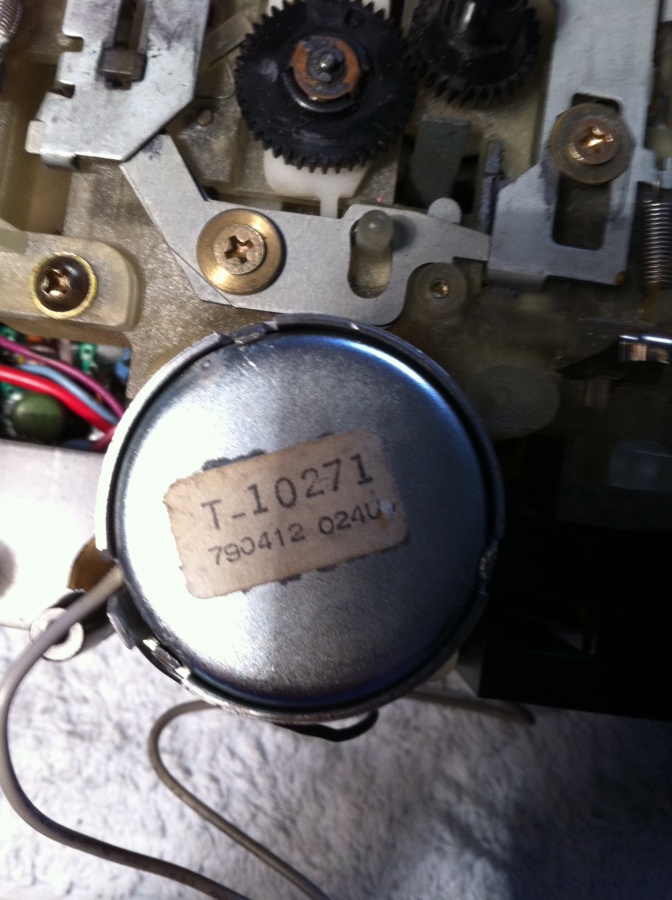

Could you do me a huge favor, since yours is apart...? I need the part #'s and words on your tape drive motor? That would spare me disassembling mine to get that info. :)

I did yeah, took plenty of pictures so I could get it all back together again!
Its closed back up again but need to open it up again because its still not working so if you need anything else then let me know. Heres a picture of the motor, is this the numbers your after?
I think my motors kaput as well, cant get the tape deck working, belts seem OK but nothing is moving...Where are you getting a new motor from?

Yes, thanks!!!! Not sure where I'm going to score that puppy... but with the numbers and access to a rather resourceful technician, I'll make sure to order an extra for you if he says he can get it.

Just done a little more research on motors and I dont think those numbers are the correct ones for getting a new motor. The numbers dont show the voltage or direction! As far as I can remember there are no other numbers on the motor but I will be opening her up today again so I will have a look!

As for the motor -- before you go further on this, why don't you confirm that your motor is dead? Just because it doesn't work doesn't necessarily mean it's dead. Check the motor directly with a 9v battery (following correct polarity) by jumping it and see if there's life. If there is, you need to look further because the problem lies elsewhere. Unlike soft touch controlled decks which continues to power a motor when belts go, manual keyed decks will shut off the deck when the key is not depressed. Obviously, when belts fail, there is no reason to keep the cassette keys depressed except for trying to monitor the line-in circuit. The point is that motor failures are more common in solenoid soft touch controlled decks than with manual keyed decks.

How do I know I have the correct polarity? Is it indicated on the motor or at some point on the wires path, etc?
Thanks.
The polarity is important because some motors have internal speed controls and reversing polarity can sometimes damage that circuitry. Normally, the polarity is indicated either on the motor solder pads, or via wire color. Red is typically positive and black is typically negative. If neither is intuitive, then you can usually tell by following the wires and the resulting solder traces. Ground paths usually services multiple components and have large traces, sometimes even islands.
If power is not getting to the motor, replacing it will obviously have no effect.
